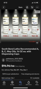

Picked up 2 south bend lathes the other day. A heavy 10 and a 13x7’. Both came from the same shop and are in great shape but looking in the manuals that came with them they call for oils that either aren’t made anymore or labeled as something else. I’m new to using a lathe so forgive me if this is a stupid question but what would be best for lubricant for them. I have been using a 90w gear oil but didn’t know if that’s what I should use or not. Maybe synthetic gear oil? Or should I use different oils for the spindle bearings, gear box and ways? What do you use?

This kit is well worth the money. Replace the all the felts.

I second this advice. I ordered a similar kit and installed it in my Heavy 10 when I got it. A good investment.
Thanks guys. Ordered the oil kit from eBay. Will get the rebuild kits a lil later after I use them for a while and get more familiar with them. Also need to pick up a 4 jaw chuck for the 10 and a floating reamer holder.
Type B- DTE 24/ISO 32
Type C- DTE Heavy/Medium ISO 68
Vactra #2 Way Oil
I still have the original "A" from the kit from 7 years ago...very little of that is used (spindle bearings and apron).
Know that these rely on felts to wick the oil to where it's needed.
If the machines have been sitting for an extended period, or the felts have not been replaced in a decade (SB recommended 7 years)- you risk the felts not wicking the oil. If you don't know how to evaluate these machines I recommend you buy the rebuild kits- and at least read the manuals so you know how they work and how to evaluate them, and adjust tolerances. WIthout the manuals, you won't even know the oiling points (some are easy to miss) and which oil to use.
