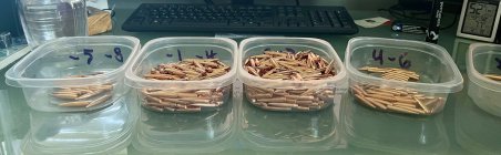

I usually only shoot out to 200 yards. For my 6 Dasher, I shoot the Berger 105 hybrids. Would sorting bullets by overall length do me any good? I seat the bullets using the BTO process. I opened a box and sorted them anywhere from 1.244 to 1.259 inches. What makes sense? If sorting by overall length, do you group certain lengths together, and maybe use the outliers for blow off shots or fouling the barrel? Thanks for your time.

I shoot custom bullets so thjey're pretty consistent right out of the box, I sort by OAL and run them on Bullet Genie to eliminate any outliers
I use CTK Precision caliber specific trimmer attachment that indexes of the ogive, I sort my bullets into.003” piles then trim .010” before pointing
Sorting by OAL and then indexing off the ogive is a waste of time. Using the ogive as the constant reference point through the entire process , trim, sort OTB, then point. everything uses the datum point. I assume your pointing die references off the base of the bullet which makes the OTB base measure key to lot sorting.
I hear a difficult part of making the bullet is drawing out the tip. Using Bob Greens tool designed to measure this to the fourth decimal pont I separate into usually 3 piles. The last 500 107SMKs where so consistent I did 2 piles but it reality they where all within .0001. Then I separate those piles by base to ogive normally into 3 piles based on 3 decimal points. My loaded rounds measured base to ogive with be within plus or minus about .0025. The last 3000 107s have been remarkable less one 500 box. Must have been the culls, lol. All from the same lot. Separated into about 8 different piles plus about 20 relegated to sighters the remaing piles shot fine. Yes they need sorted because maybe 1 or 2 every box become sighters normally, some times crazy different. But I have done well since I switched to them about 6 years ago. The tipped versions have been a step up. I sorted custom bullets also. That one bad one will cost you a match.
