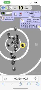

I tried just about everything i can think of to stabalize ES and even when it is reasonable like in the 8 range the targets are all vertical. I've posted some targets below. I have dozens more that should all be 200-19X or 200-18x. I don't have a wind problem. I have a vertical problem.

And, lastly, here is what you get on paper:
Wide open to any suggestions you guys have.

My brass looks the same and shoots the same way with a .315 neck and .203 FB. My SD at 600 on the shotmarker is roughly 16 fps.

Low pressure loads and/or slow powders will look like that....not enough pressure to seal the neck quickly and the gas gets past the lower neck and into the shoulder area before it finally seals.
The vertical shape of your groups on target also point to low pressure loads.

I have to wonder if the .2844" FB may be giving you a false reading on seating depth and you're jumping the bullet. Do you get land marks or a ring on the bullet? If possible I would come out on the seating depth and see if that increases pressure enough to flatten the groups some.
Good morning, Dave. I am jumping the projectile about .022," touch - .022, but I've tried it Jam - .02 which should still be .004-.006 in the lands. I wasn't changing seating depth due to the soot, just looking for the right tune. I will try in the lands again just to see if that cleans anything up.

Dave, I saw that on the print and wondered about that. That snug of free bore diameter can cause a lot of gas not only with accuracy but as you pointed out...a correct seating depth. We see this at times in the 30BR's. -Al
Hank, to Dave's point....before doing anything else, strip the bolt and seat a bullet long enough to be well 'in' the rifling....like .015-.020. Polish the bullet with some 0000 steel wool, close the bolt and see what the marks look like. Post a pic of the bullet.
Dave's question: "Do you get land marks or a ring on the bullet?" may be a nugget of gold. :) -Al

The groups and the soot indicate low pressure. Don't overthink this unless you've ruled it out. If you don't have pressure signs, bump the charge up on that thing or try a faster powder.
Wind can induce vertical, specificaly head and tail winds. As can lighting or mirage. Tune can induce vertical. Gun handling, a nose heavy gun and a front bag that's too hard, can induce vertical. I'd KISS it before looking for less likely issues. Once you rule out the more obvious stuff, then look at the other possible causes.
