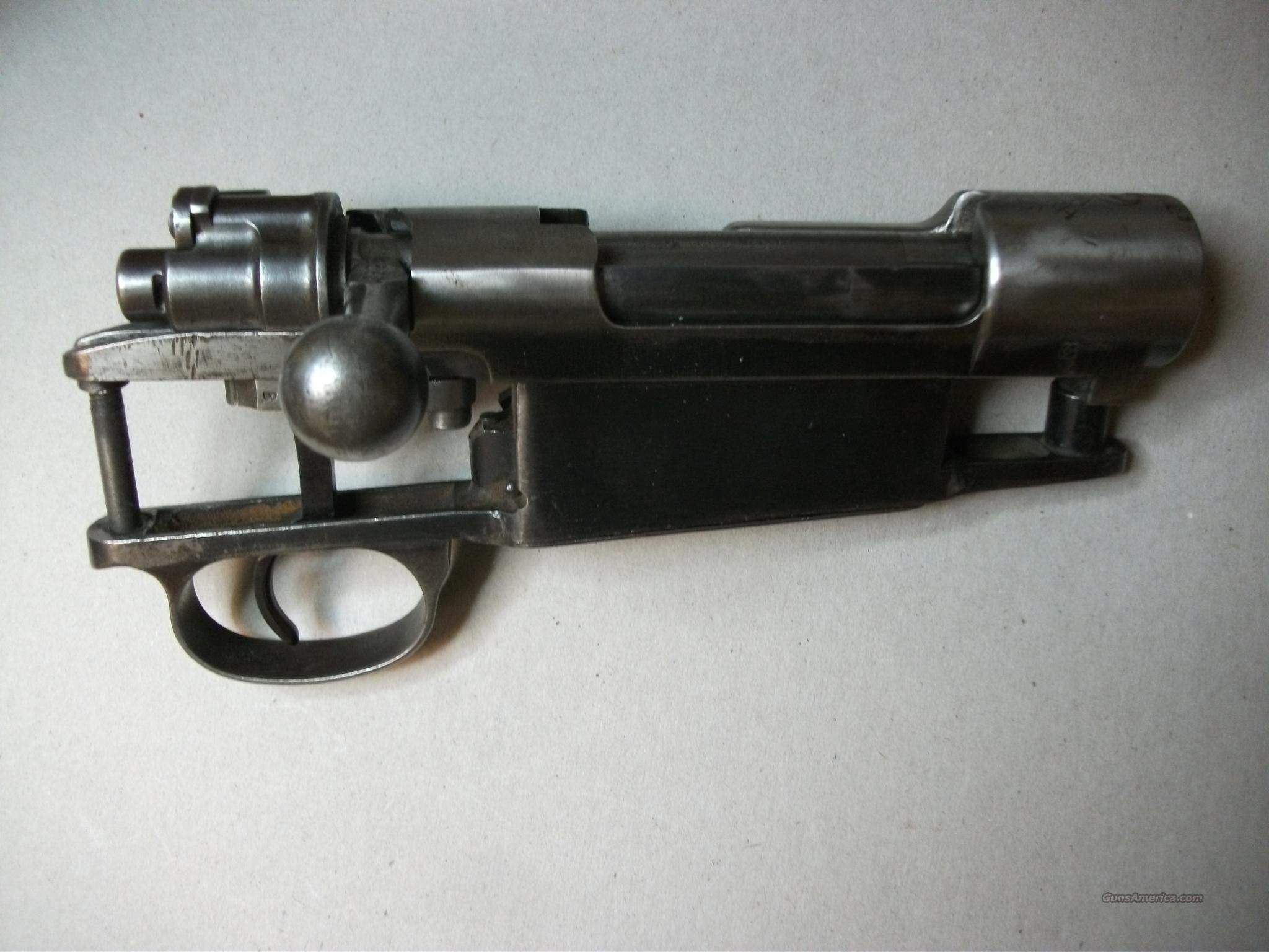

The beautiful pictures of the Mauser action in Kurz's entry is missing a VERY important piece
that is very often eliminated in sporterized Mauser actions.
The rear action mount screw should have a metal sleeve around it. This sleeve is a pillar. Mauser actions get a lot of their accuracy from being pillar bedded. The front pillar is cast on to the front mount but the rear pillar can be removed or simply ignored. Not a good idea.
My home built VZ-24 98 action, made in Czechoslovakia during WWII. was carefully bedded with its rear pillar and will shoot less than 1 MOA with a cut down military 7X57 barrel!
Actually, neither action has the sleeve you mention because I make them in bulk and grind them to size as I need them depending on the stock. So when I assemble an action for pictures, I rarely put that rear sleeve on in an attempt to to avoid someone mentioning that it might be too long...:rolleyes::(;)
