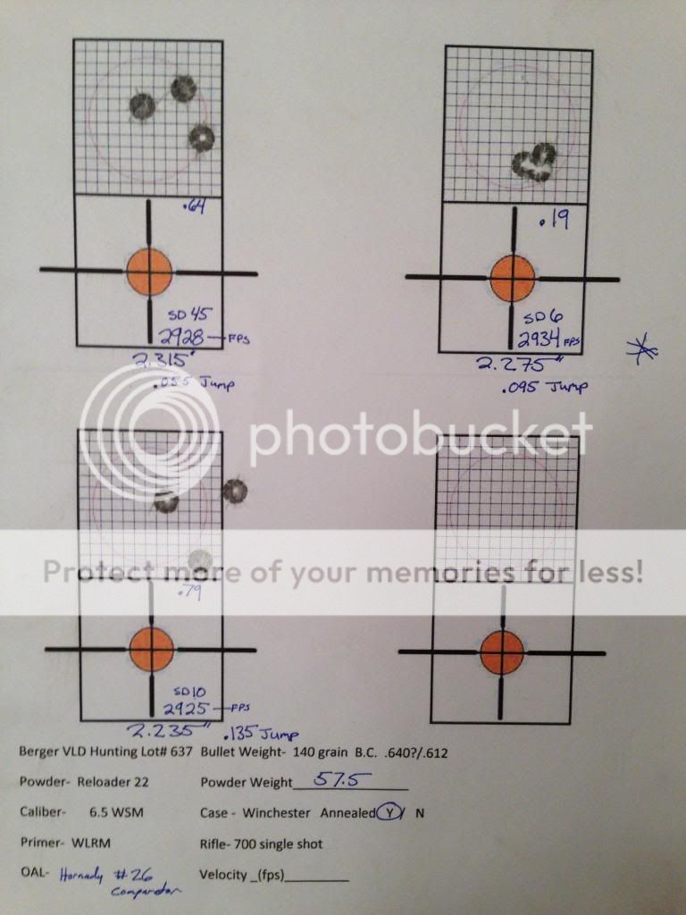

Thank you for the feedback. The barrel has less than 100 rounds through it. I am actually happy with the last session at the range. I will post the actual results with some pictures of the groups later. But off the top my head most group less than half an inch and 100 yards with a couple in the .3-.19 area. But that is from memory just like a fishing story it grows.
I was just getting greedy, I wanted 3000-3100 fps not 2890 were I had a tight group.
If you could check back after I get the pictures posted I would appreciate it, I am looking for a little advice on what you all would do next.

Here are some pictures from the my 10-31-13 trip to the range. Previously this summer I had trouble with the Lee FL sizing die, then the seating stem was not working with the VLD. With the Redding S type die and drilling out the stem, the huge run-out is solved. I will also post a link to all the pictures of the 6.5 WSM targets at the bottom of the post.
link to all the targets so far
http://s220.photobucket.com/user/troyrev800/library/Shooting/WSM?sort=3&page=1
Hind sight being 20/20 the seating depth was not correct and the run-out was huge.
Annealing usually helps the accuracy, especially at long range. When the 6.5 WSM came out, a lot of people at Williamsport built one. Now nobody shoots one. The accuracy and barrel life is just not there. One guy got his shooting pretty good but that was after shortening the case three times. If you want good accuracy, (something easy to tune) build a 300 WSM. The accuracy and scoring ability are really good. Guys that shot 1000 yards for 20 years and never shot a 100 score built a 300WSM and shot multiple 100's since. This is not just one person, it's been multiple people.
So I re-tested a couple of loads and also 2 groups of the other primer and 60.5 charge (warm)
I am going to call it good and run with the New NON annealed brass
57.5 grains with the HUGE jump .095@ 2.275" Approx .50" groups
Also during this cold weather I am also going to shoot the 60.5 grains (BR2) at 2.380 .010 in lands---That one shows potential
Just practice some more.... FYI I had a great group with my STOCK .308
Problem with the 2.275 length in the non annealed brass. I must be hitting that "dough nut" ?
There is a seating resistance increase when seating that deep, then the bullet is very loose after the resistance is past. Two of the five I accidentally move the depth with the caliper while measuring. I think that load is out due to that and the fact I am not willing to buy the K&M neck turning equip (w/cutter mandrel) just to remove that issue. Is that normal it was not as noticeable with the annealed brass?
I will just focus on the RL 22 with 60.5, BR2, but am still worried that when summer comes back I will have too hot if load. I stuck bolt in it this summer with that load. However the gun had nearly no primary extraction at that time. I have since fixed that so I have about .080 vs the <.030.
I just do not want to end up with 100 loaded round this summer I can not shoot, and then need to find another load.
Thank you for you feedback
