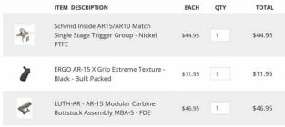

Here's a couple upgrades.
Shop around but JoeBob (free shipping over $90)
FDE or Black available.
RV, thanks for the JoeBob site. Never been there before, and it looks good. I'm a big EBay guy, but it's not very AR friendly. jd
I bought from joebob, I like them. fast shipping as anyone.
