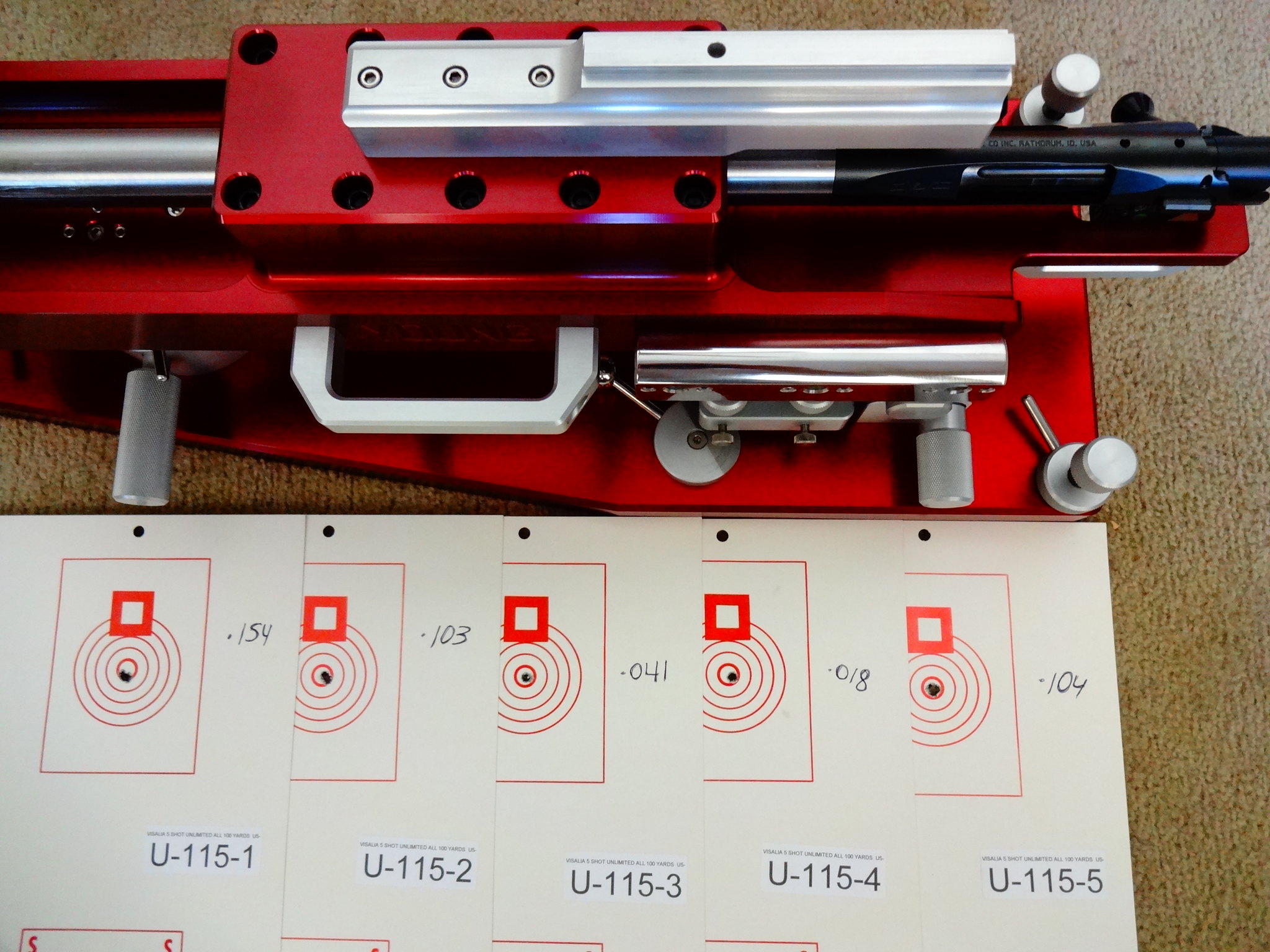

Last weekend my friend Gary Ocock shot a 100yd rail gun aggregate of five five shot groups in a fun match conducted exactly like a sanctioned one. It was .0840, well under the records of both the NBRSA and the IBS. Previously he had tested his particular setup (barrel, chamber, bullet) to see whether there was any advantage to using more neck tension. There was not, so he stayed with the bushing that he had been using for surplus 8208 which gives him .001 neck tension. I have been a big advocate of lots of neck tension for the typical .262 chamber neck 6PPC based on my results and those of others as well, but this case was an exception, which makes an important point. Do your own testing. What works for some other fellows may turn out differently for you. BTW the load for the smallest four groups in that agg. was very hot, and his bullets were seated at jam. He shoots his own BT bullets.
DSC00569 by boydallen, on Flickr
