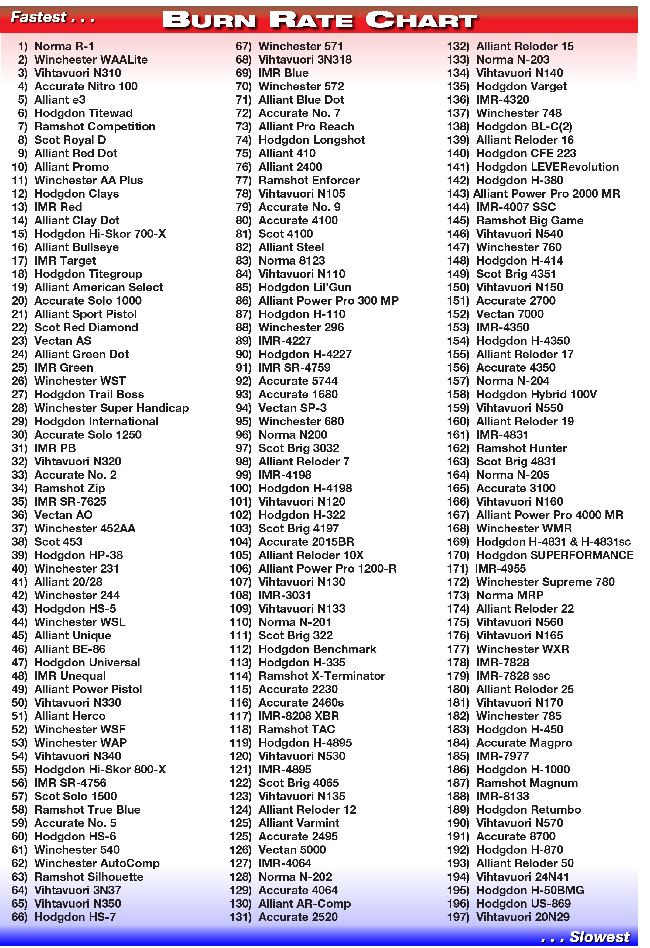

The Forum Boss posted the newest version of the Hodgdon/IMR burn rate chart on the Bulletin. It's an excellent example of useful information for all reloaders. Print it out, download it as it is easy to use.

While searching out some additional information, I ran across this version of a slightly larger burn rate chart:
Use it for comparison since there can always be a slight amount of dissimilarity between authors. None of these are fixed in stone, especially considering the variations in lots. It's all good information to help us be better reloaders.

Yes, many of us have our old standbys, new powders coming out often though. I recently bought 9 lbs if IMR 8208, lots of good reviews. Most of what I load for calls for rates in the TAC/4895 to just a tad slower range, Varget to 4350.
Rarely if ever have I found T30, T32 on a burn rate chart. I've always had to interpolate found loads with the case I'm thinking of using with those two powders. It's a nuisance but it gets me close.
These lists seem to lack proportionality between powders. In other words, you could have two powders five or six positions apart from each other but be closer in burn rate than two other powders in a different place on the list that are only two or three spots apart.
Has anyone ever seen this list shown in a graph or plot that takes the proportional factor into account?
Yes and so is Re-33. According to Alliant, they are not releasing the closed bomb data to anyone, it's being kept inhouse only. So call Alliant and ask them to supply the data so we can update the charts.;):)
Funny thing, burn rate charts are so far from the truth as to actual rates between manufacturers that they are simply a rough guess at best.
RQ (relative quickness) numbers between manufacturers are NOT set to any given STANDARD.
So IMR May give 4895 a RQ number of 100, then all other powders faster are given lower numbers and all other powders slower are given higher numbers.
Then Hodgdon gives 4198 a RQ number of 100 and the same happens as above, then a list is made by HOW the manufacturer states THEIR burn rates in order of RQ numbers, which are not relative to anyone else’s burn rates but ends up on a burn rate chart.
The other problem is that burn rates are not constant and change as case shape/size/bore ratio changes as well.

As for listed burn rate, myself and two friends found a stark discrepancy in the latest chart. That being, H1000 and N170.
We we’re working with the 7mm Geramo, which is a 6.5x55 necked up to 7mm and then Ackley Improved.
We found H1000 to be very accurate with 162 grn ELD’s. We wanted to try something just a little faster because the H1000 was a compressed load.
Ed got some N170. We dropped the load a couple of grns, but to our surprise, the velocity was wwwaaayyy down. We finally ended up with just about a full case, and the velocity was still an average 200 fps slower than the H1000.
TIf you look at that chart, you will see it listed before H1000.
By weight and volume in a given case, that simply is not true. By a long shot, (pun intended).
