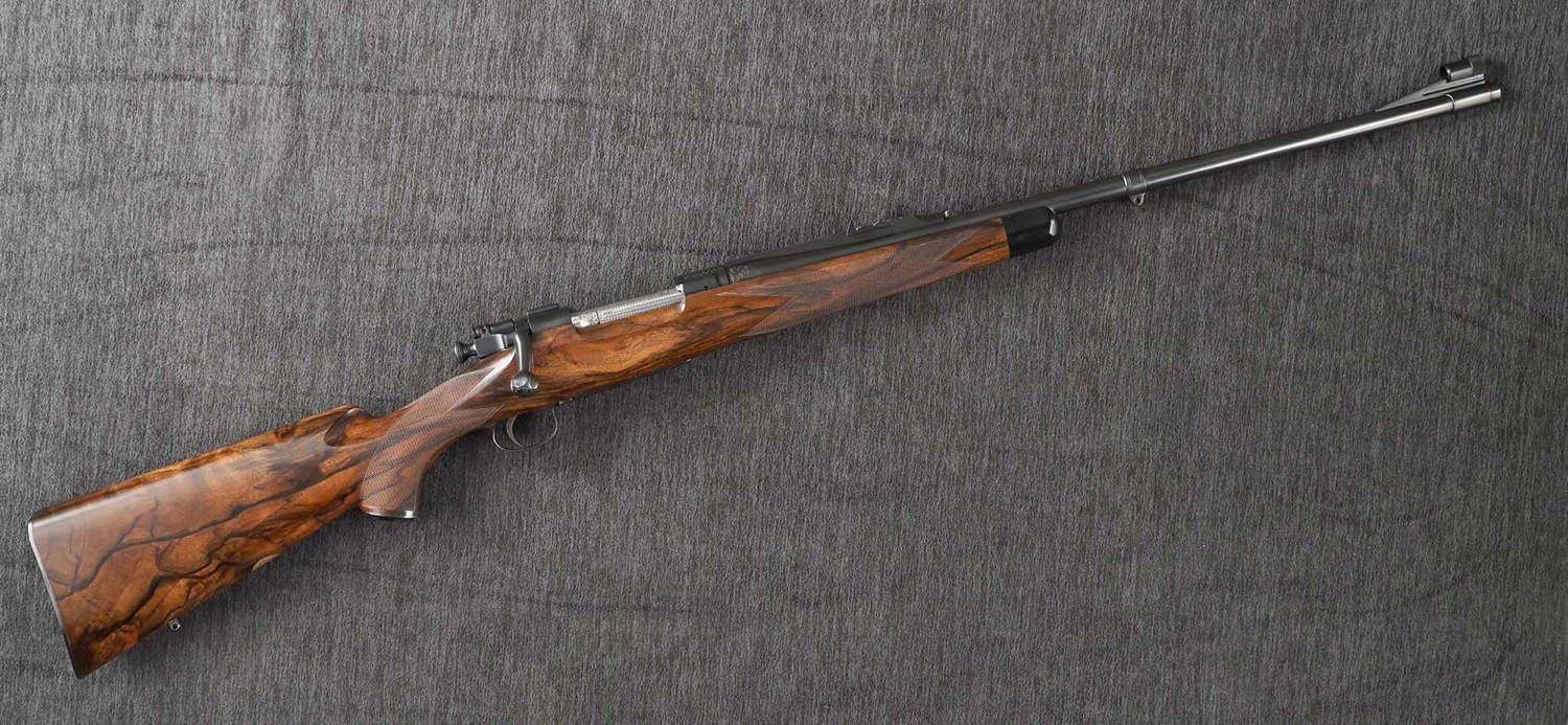

Fixing this level of ugly would probably be best accomplished by making it look like a British or European hunting rifle. Welding on a tall bridge on the front and rear of the reciever for a scope mount, rebarreling with a premium barrel, adding barrel bands/rings for sling, welding on a new bolt handle, reblueing, and putting a nice piece of wood on it would be best.
This is how it is properly done. https://griffinhowe.com/custom-products/classic-sporter-rifle/
