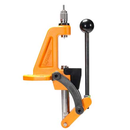

If you want to go small, real small I recommend the Lyman C-Press, or or RCBS Partner press. The Lyman is very strong for a small open front press. ON sale right now at midsouth.

If small and budget are your main concerns, then any of the main companies open face or small O type will serve you very well for years. However with just a small amount of added space, a good RCBS Rock chucker would be better and last a lifetime.
