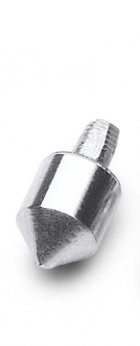

I need the "Retainer Pin"
I have the spring and the sliding plate.
Lost pin while cleaning bolt face.
Action Stiller--Viper 6 ppc bolt face
The BAT and Panda pins are too large
Ideas--information on purchase site appreciated
CLP
CLP
If it is a solid pin use the shank from a fractional, number or letter dril that is the appropriate size for a press fit. Cut it to length with an abrasive cut off wheel in a Dremel or similar tool.
If a roll pin MSC, Fastenall, Grainger or a local mill supply house.
A basic set of in gauges has provided many with an emergency pin that has fled the scene.
I think youre thinking of a different part. This is kinda funnel shaped and sits inside the spring. It has a nub that goes up into the hole on the sliding plate
Thanks for the education! I "assumed" it was a retaining pin of sorts. Clever design and more reliable than the spring and ball used on some less expensive actions. May investigate turning a similal piece from hardenable material to retrofit a Savage bolt head that had the ball lock up on the 19th round of a 20 round match jamed the plate and wouldn't allow the last round to chamber. Have since fitted a larger ball which is functioning fine.
Yes these are way more reliable than the ball
