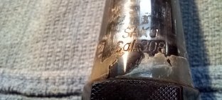

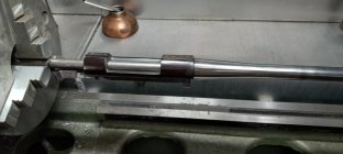

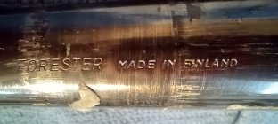

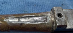

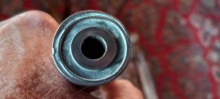

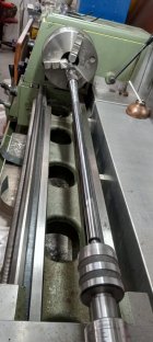

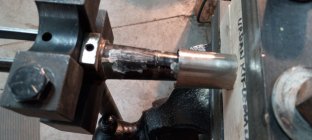

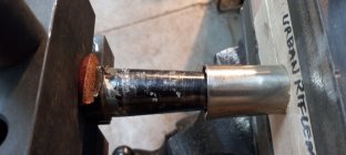

Purchased this, found a steel barrel with a SS sleeve and 8 oz. Sako trigger without a safety. Looks like the sleeve is glued on, I'm looking for advise on how to remove the sleeve. I used a barrel vise and action wrench, no heat. This a 23" original Sako barrel. Now to remove the old glue?

What is the first picture of? It looks like a bunch of material has bee removed from the barrel.

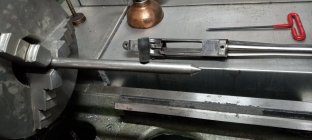

If I had to absolutely remove the sleeve I'd set it up in a lathe and turn it off. Best to put a new barrel on it.
That's what I'm going to do. There is some checking after the throat, but the rest looks good.

I'd like to see if the barrel under the sleeve is the original Sako. I will remove the barrel and "SPIN IT UP" (why do they say that?) remove the sleeve on the lathe. I'll keep posting.
