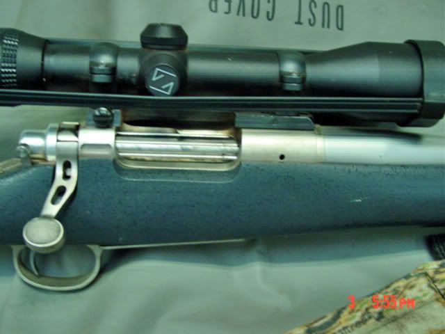

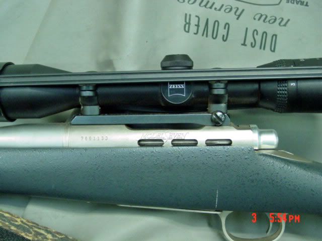

This is my Grandson's 30BR hunting rifle. It has a Brown Precision 16 oz stock and a #2 contour 20" barrel. When you are a sophmore football player and benchpress 300lbs., you don't need a light rifle. He did need a light one 6yrs ago and he won't let me redo it.
