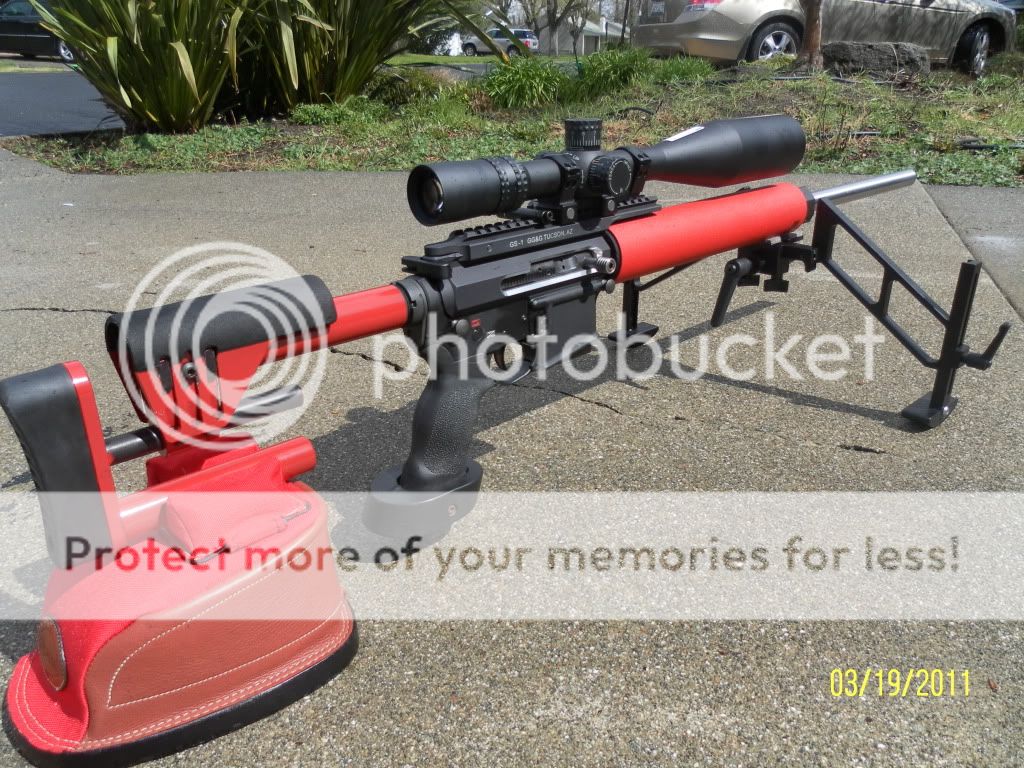

The details of Bigg's prototype are pretty easy to see from the photos. Just need some aluminum and a mill.
I shot Biggs's bipod gun in Phoenix this last January, that elevation adjustment is worthless if you can't reach it! My arms are too short!
;D
A good point, Jerry. If you cannot use a control, it doesn't help. What we need is a lightweight co-ax head integrated into the bipod. It would not need a huge adjustment range, just enough to move around the target. Say, 5-6 MOA in any direction.
