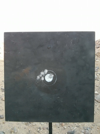

Ten shot group at 600 yards this morning...
Off of the Sinclair...
My Optimistic Scoring calls it a 97-3X. (Would probably be less if on paper... Might have been better if I didn't switch ammo at 5 rounds...)
So here are my comments regarding this thing:
I know I changed 2 things and maybe 3...
1. Thanks to whoever, wherever, made the suggestion about a piece of foam under the bipod. I didn't have anything fancy; I just grabbed a couple of large foam-filled shipping envelopes and put that under my shooting mat.
2. I used a much stiffer rear rest, instead of my usual squeezable rest. (That might have been a Jade question/comment.)
3 (possibly). I was much more meticulous about making sure the Sinclair was setup at the same height as my Harris Clone. I also paid much more attention to making sure all of the different adjustment screws were tight to the point I thought I might break something off. There was definitely non of the wobble that I read about in some posts. (I thought I felt some last time, before I knew it might exist.)
Big thanks to Seymour and Jade for their PMs. I do have a Flex Bipod on order based on their recommendations. After reading their messages and a couple of evenings of reading, it seems that it will be a better match for my shooting style, coming off of using the Harris type for so long.
BTW, does this qualify as Big Guns Porn?
BTWII: I'm just looking to get a Mid-Range Master rating. (I know this ain't going to win any matches, but this kind of shooting will help me get that rating.) I've shot out to 1Km with a different gun and know that, although I might try it at a match, or two, I'm not interested in the pain required to become consistent out beyond 800 yards. I'm getting a .338LM for that next...
