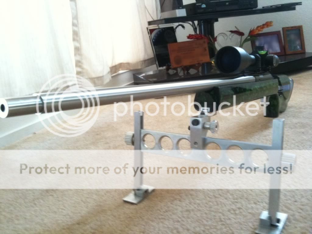

I built this one from aluminum scrap in our shop. I drilled a lot of 1/2" holes in the underside to lower the weight (looks like swiss cheese from the bottom) and it's right at 4# now. Top is leather w/leather sides, and it mounts to a 5/16 UNF bushing I installed in forearm of my Savage. Very stable off the bench and ground (prone) and extremely adjustable. I actually like it better than my benchrest tripod. It's almost like cheating shooting with this system!

Here's a couple of photos of my rifle with the Centershot (before I changed the feet):
