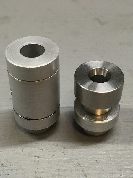

I use the Hornady inserts in the Sinclair Comparator body and they fit just fine. The two brands of inserts are not the same; I have both. The Sinclair inserts are steel, Hornady's inserts are aluminum. The Hornady aluminum inserts also have a slightly smaller hole, at least the .22 and .30 cal inserts do. As a result, they seat a little further above the end of the bearing surface on the bullet ogive than do the Sinclair inserts.
The products can be used together but are not cut the same . The bullet comparators are cut at different diameters .
Top line is where the Hornady contacts the bullet . The bottom line is where the Sinclair contacts the bullet . The Sinclair contacts much closer to the actual diameter of the baring surface resulting in a more accurate measurement if you're looking for your touch COAL .
The Sinclair shoulder datum insert is cut at a taper , more like what the shoulder of your chamber would be compared to the 90* cut the Hornady has . They do not give the same measurements at all , not even close .
So yes you can use each products pieces together . However they DO NOT give the same measurements as each other .
