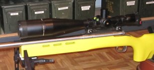

The attached image is one of my two 10-50 Sightrons mounted on my Savage F-TR rifle. 32X is adequate for most situations except when the conditions are favorable and you can use the extra magnification. That is especially true at 1000. This one has served me well in several State, Regional and National tournaments as well as our local matches at Camp Pendleton. I also own two Nightforce scopes and several Leupold, Weaver, etc. I won't debate the relative merits except to say that the 10-50 meets my needs for this application.

SleepyGator--thats a nice rifle.
