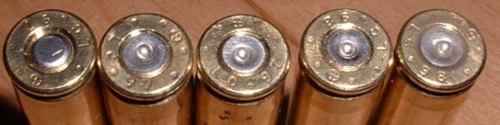

Test: Ruger #1, CCI 400 small rifle primers, LC brass once fired
processed from Scharch and prepped by me, 55 gr Vmax moly, H335
pic left to right: unfired, 28, 29, 30, and 31 gr.
unfired, extractor groove .329'
28 gr, extractor groove .329', 11% overload 69 kpsi Quickload
29 gr, extractor groove .329', 15% overload 80kpsi Quickload
30 gr, extractor groove .3295', 19% overload 92kpsi Quickload
31 gr, extractor groove .3320', 23% overload 106kpsi Quickload
What does it all mean?
The 270 is SAAMI registered at 65kpsi, but can only get long brass life at 62kpsi.
While the .223 is SAAMI registered at 55kpsi, and can get long brass life at more than 70kpsi

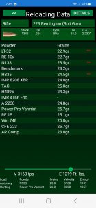

I know I'm a little late to the conversation, but I had the same question and my field testing last week gave me the answer loud and clear! I was using the V5 manual and 335 pushing the Sierra 55 gr. #1390.
When I got up to 26.6 Gr. the group tightened up to just under 1/2 MOA with no pressure signs. Next load was 26.9 Gr and I got a really tight .35" group,(pretty good for my RA) next was 27.1 and hold the phone! The first, and only, shot showed some pretty severe pressure sign as in blew the primer to pieces! I was quite surprised and went back and looked at the previous 2 loads brass (3 + 3) and no flattened primer or ejector shiners!! Winchester brass and primers. Manual shows 26.6 @ 3200fps but I'll chrony the 26.9 next week.
"Pressure signs" in primers and/or fired brass are dubious readouts at best. More often than not, by the time you see them, you may already be grossly over-pressure. Chances are good your 26.9 load is a lot hotter than you think, especially given your results at 27.1 gr. Dropping the charge weight of what is clearly an over-pressure and unsafe load by only 0.2 gr is not enough. Even if the 26.9 gr load appears safe under certain conditions, a modest increase in temperature would likely be sufficient to push it into unsafe territory. Running loads like this simply isn't worth it for a relatively small gain in velocity. You'd be far better off tuning in a lower pressure load with seating depth.
