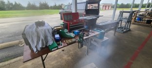

Wes, what did you end up going with? If your using the folding, fixed length "banquet table" legs, have you had any issues with the lack of adjustability on uneven ground. I hate wobbly tables.
I took a 4' fold up table from Home Depot, with what I would call banquet table legs, and bolted 3/4" plywood top to it that over hangs 6" on all sides. This allows be to bolt my press to the table.
It is stable enough.... it does flex a bit when sizing cases. I probably should have only used 4" over hang and that may have helped.
