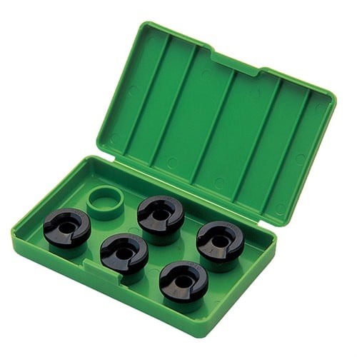

You might want to think about getting the Redding Competition Shellholder set???
Those go the other way - 0 = 0.125", 002 = 0.127", 004 = 0.129", etc. Helpful if your die goes too far. I took a set of these holders and put them on a surface grinder and now have a set that goes negative in ~0.0006" steps, so 0.1244", 0.1238", 0.1231", 0.1226" so that when I can't get the bump I'm looking for, even with annealing, I can push past the spring back point.
