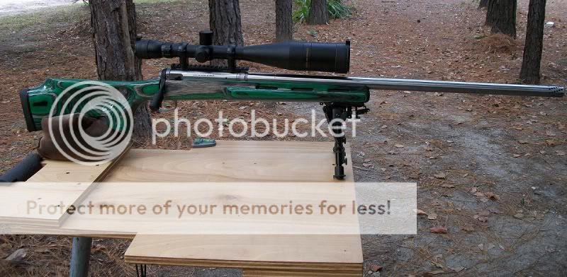

Haven't shot mine yet, but I have a Harrell's brake on it. It would be a poor choice for shooting prone over dirt, but all my shooting will be off either a portable or permanent bench. Here's pics.
I've had 2 of harrels side discharge brakes and this time I went with the exact brake you have on yours. I'm anxious to see the difference, I shoot prone a lot but I just throw something down to control the dust.
