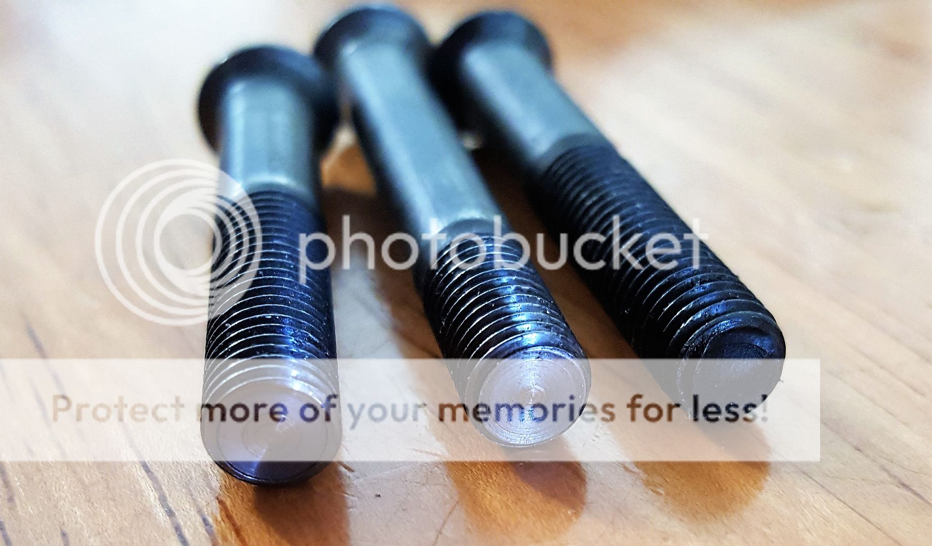

So it appears I over-use my lathe...which might explain why I'm not the fastest out there. I tend to leave chucks set up for a job so I can just swap in a chuck and be ready to go. My lathe probably spends 30-50% of the time set up for collets. I definitely should get a lathe dedicated to collets. Here are the action screws from a stock I just happen to have no rifle on right now (but that's another story). Also I photographed a stock screw I had laying around. Finish isn't great because I did it in a hurry because it didn't show.
Anyway, it appears there are lots of ways to do it but this is my favorite.
--Jerry
Jerry, If one of my lathes had the collet closer on it I would push a screw through from the inside of the collet and do the same thing. I would not tear down a setup to do it.
I will add one more thing. The threads in the action are not easy to repair and you want them to last many, many years. Do not use them to straighten out the threads on your cutoff bolt. I have an old 40X action with some bad threads on it and I sometimes spend spare time thinking about clever ways to repair those threads. Whatever way you used to cut it off make sure the threads are good before you put them into your action. --Jerry
