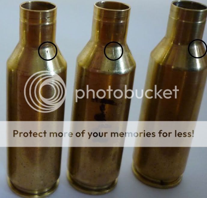

you need to anneal after every 2nd step otherwise you get puckering at the shoulders -like this -at least i did. I have found that minor folds "fire out" without issue but if you don't get it right due to major ugly folds (at least in my experience) you will end up ditching 10% of your brass
Yeah, I got a similar thing when converting 270 brass into 6mm Crusader brass. It wasn't as bad when I used 30-06 brass, and reduced both the case mouth diameter and adjusted the shoulder a little bit at each step. I find it happens when you try and make too big of a change in one step. That's why I got the 300 RUM cases instead of 7mm RUM.

I finally got around to making my shoulder set-back die. Works pretty well.
I anneal the case and then knock down the shoulder in 5 steps using progressively smaller bushings that have a 20 degree shoulder angle. Then I anneal the case again and run it into a bushing with a 35 degree shoulder. Forms well, no puckering at all. From this point I would run it into a neck sizer to get rid of the radius at the neck-shoulder junction, then run the expansion mandrel into the mouth, trim it to the proper length and neck turn the case.
