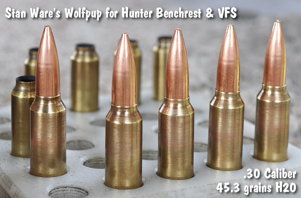

Were they this short?
http://bulletin.accurateshooter.com...de-the-box-stan-wares-wicked-no-neck-wolfpup/
