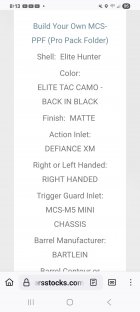

Is your action a medium or XM a medium action is listed as a short on manners web site.
It’s the folder stock that I’m interested in that is only offered in sa la. I emailed them and ask if I could have it custom done and they responded they couldn’t do for a medium.
Looking at Defiance web site they changed the name of XM actions to medium
I was thinking they were the same but also remembered a action they came out with that was a little longer than a short action but used the same footprint as a short action (mounting holes)
Here is email between their sales and me the other day but I do see xm on their inlet list same as you did

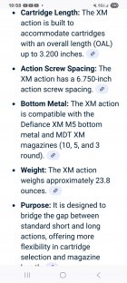

The xm action has a bolt spacing of 6.75"
