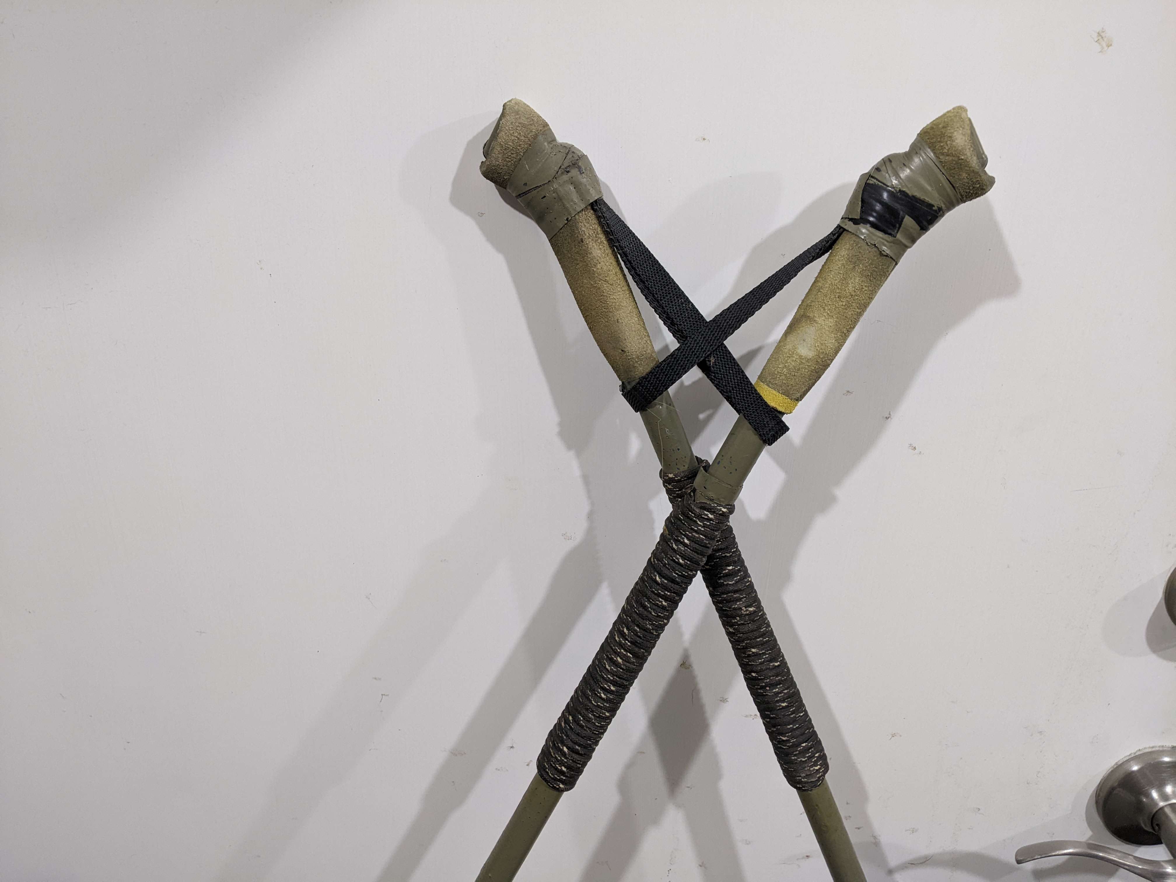

Simple sticks from trekking/XC ski poles. I used to ski and snowshoe into stands when I hunted the northern tier of states. Ski poles made great shooting sticks, you already had them with and you don't need to carry anything extra, further south or earlier in the season trekking poles work also plus they are handy to poke around for Buzz Worms before you sit down. How to handily turn trekking/ski poles into shooting sticks.

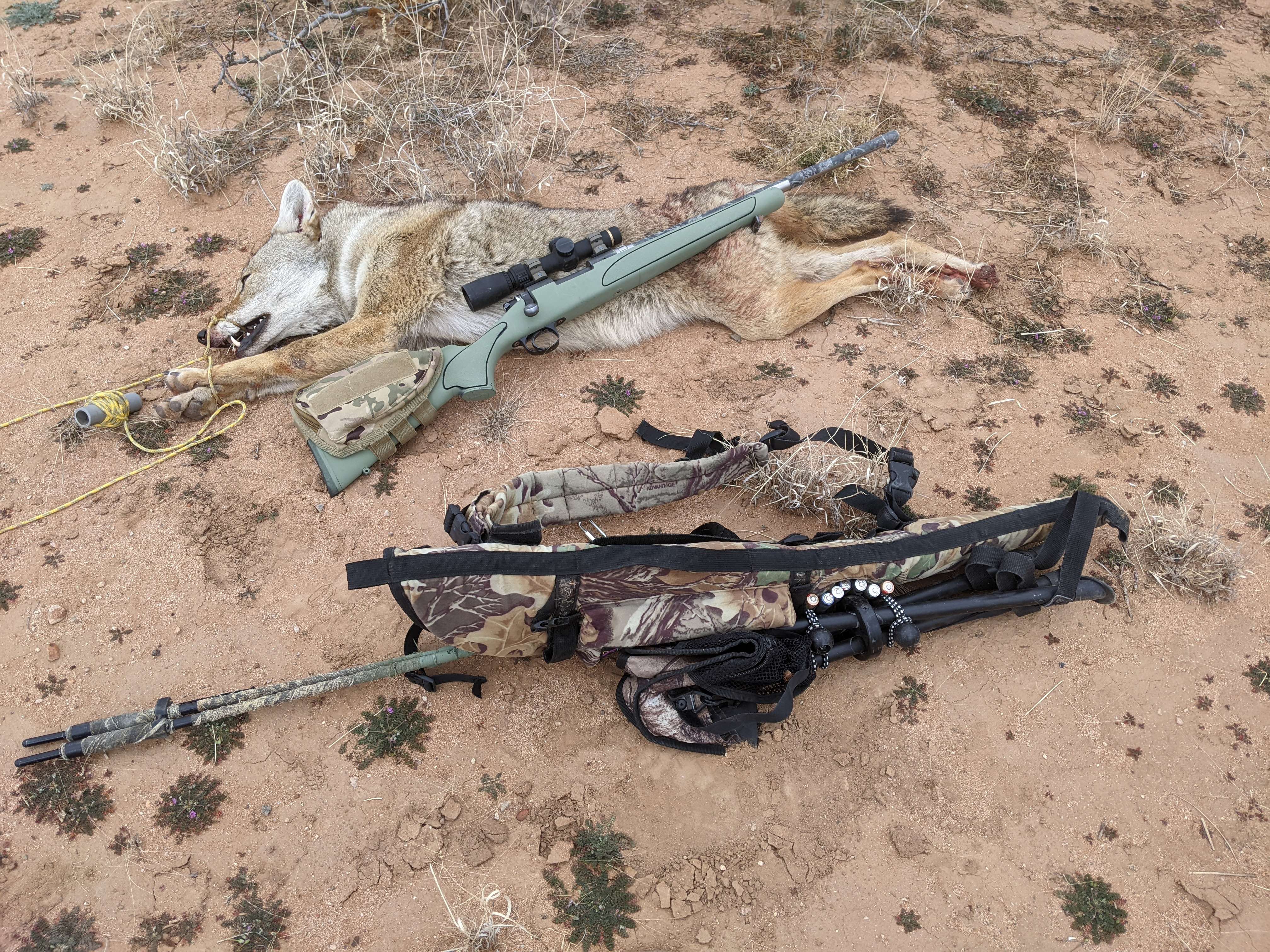

I started extending "Snyper Styks" to work off a stool. and make my own from tempered aluminum tent pole kits. A kit makes two sets and they are light and handy adjusting to any height.
you can see my extended poles sticking out of my scabbard, makes getting to the stand easy and riding the MC, Mountain bike or skiing easier freeing up the hands.

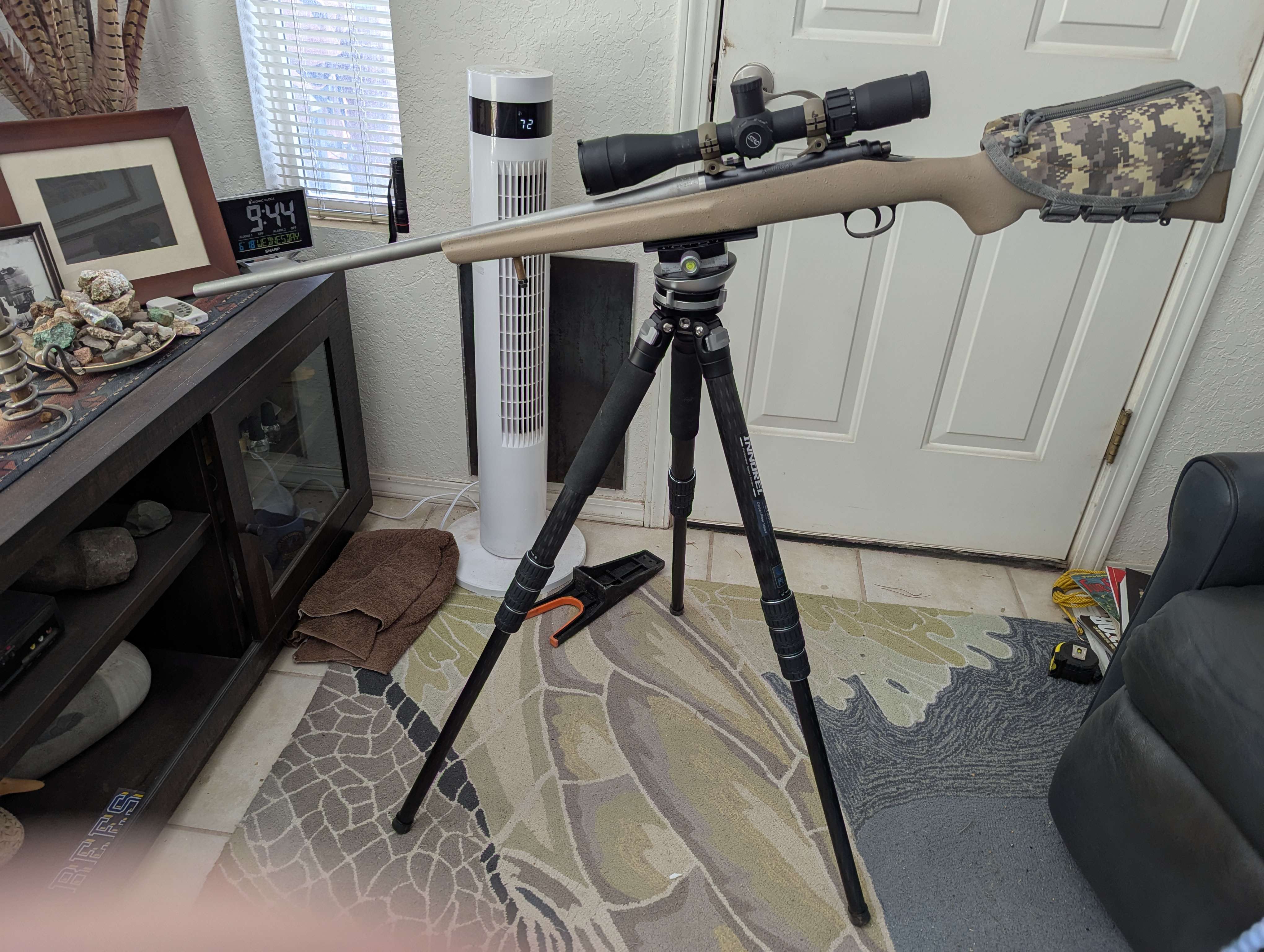

It is much easier to make a really nice light tripod. Perusing through Amazon I found a 55# capacity carbon fiber tripod, 90 mm leveling head and Acra Swiss clamp for under $200. Boom a great tripod.
What I use in the field.
Im with ALF. I used every kind of stick imaginable(two legged) in the last 40 years ish,dont get wrong they work but for me a tripod is now my go to.I can almost get under mine, always one leg against my leg(s) with a single leg always facing forward.i shoot one handed so my left hand is on the leg out front.
