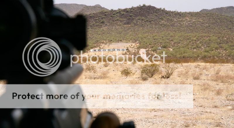

TY for your kind comments on my pics. I wish I were still interested in getting out and creating them, but if I were, I wouldn't be involved in THIS crazy obssession.
The 1000-yard target butts at Three Points w. of Tucson, AZ, fotografed with a fairly long lens.
