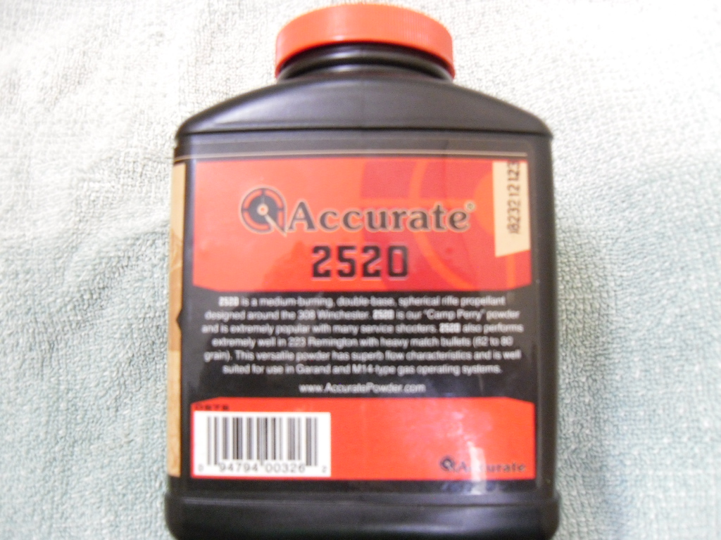

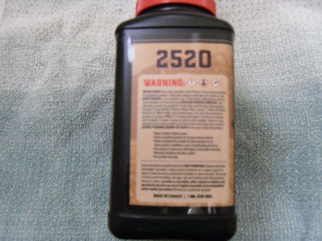

I know the image is not clear but the side label at the bottom shows it's made in CANADA
H4831, H4198, H4895, H4350, H322 have been made in the US, Scotland, & now Oz.
IMR 4198, 4320, 4064, 4895, 4350, 4831, & 7828 have been made in the US & now Canada.
Ramshot Big Game is on the shelf made in both Canada & Belgium.
Accurate 2015 has been made in Israel, China, & a few other places until Canada where they make it today. I just finished a pound of their 2460 from the early 90s that was made in Israel.
I'm sure there are many other examples.
Just cant depend on nuthin'.
The original Accurate Arms Co. started up the same way as Hodgdon - sourcing surplus powders. They took a lot from Israel including the original AAC-2520. It was this early batch that acquired the nickname 'The Camp Perry powder' as it suited 308 Win with the 168 MK in M14/M1As so well.
