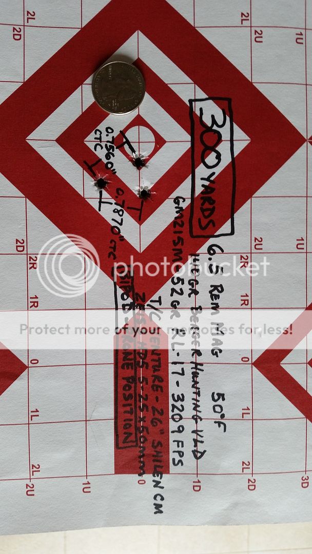

This group was fired from my custom 6.5 Remington Magnum sporter hunting rifle at 300 yards in the prone position on the ground (small dirt hill) using a Harris bipod. The barrel is the cheapest blank Shilen offers. It is Chome Moly, (no hand lapping) and is a #5 contour, 1 in 8 twist, finished at 26" long. Paid $150 for it as a "blank" on MidwayUSA then had my gunsmith contour and chamber it. Barrel is mounted on a trued Thompson Center Venture 3 lug action with the factory stock and trigger. Action and barrel were bedded by me using Devon Steel Puddy. Group was shot using a new Zeiss HD5 5-25X50mm scope set on 25X.
If a plain Jane CM Shilen can do this from a bipod, imagine what their high grade SS hand lapped barrels can do in the hands of a skilled shooter with a nice BR setup. This group is all the better I can do from a prone field hunting position using a Harris bipod. The gun will probably shoot much better than me.
