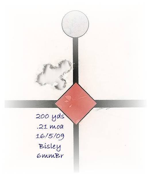

Although I have nothing to compare it against I'm very pleased with my Shilen Pre-fit barrel for my Savage 12F. It's a 6BR Stainless select match with a 1 in 8 with 4 groove ratchet rifling. Here's a 200yd 5 shot group shot with this barrel. (108 gr Berger, Lee press, redding dies)
