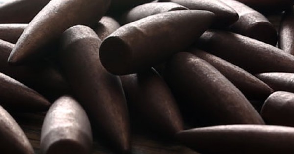

I would shoot 10 Tubb TMS bullets through that bad boy.
