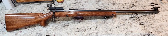

Depending on how much shaping a Nicholson #50 would be my goto. Then 80-400 grit. Wiskering between sandpaper grits. Then whatever oil/varnish you like. I use a couple different ones. Heres a picture of a 52B I saved from winding up as parts. Stock was a mess but perfect metal thank god! Yes the stock is orginal, finish is better than new!

Thank you all for the help. Im gonna try to work on it over the holiday weekend here. I mainly want to remove some of the "bull nose" of the front and thin it out a little. Just feels like im holding a 2x4.
