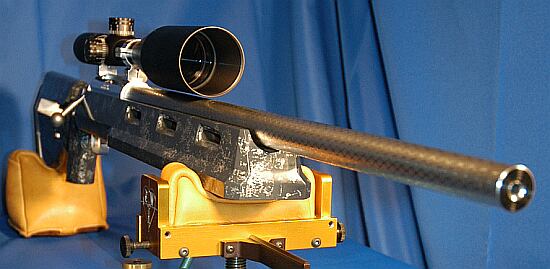

Here are some pics of my Speedy F-Class stock, well actually Speedy built rifle. I just got her back from getting a Kav paint job. He is an artist and a craftsman!!!
The stock does track exceptionally well, and, IMO, works both for F-Class and off the bench for long range BR.
The only change I have suggested to Speedy is to slightly alter the geometry of the adjustable cheekpiece. My suggestion was to have the front of the cheekpiece come straight up instead of canting forward like it does. Due to this cant, when it is raised, the bolt will hit the cheekpiece. If it came straight up, the bolt would not travel far enough rearward to hit the cheekpiece. Other than that change, I could not be happier with the stock!! :D
Just click on the pics and they will get bigger. For extreme detail, click on the pic again and it will get huge.
Thanks for the pics, that is one beautiful rifle and great photographing. I can really see all the lines and details. It looks like both the cheek piece and butt pad are adjustable. any other feature I overlooked ?
One more question, are these 2 different design of stocks the SG&Y offer by Robertson and the one you can get from SG&Y?
They sure look identical to my untrained eyes.

Thanks :D Yes, both are adjustable. Further, the butt pad is adjustable for both height and cant, so when shooting prone it can be set to fit perfectly.
The SG&Y is made by Robertsons, but I don't know if Robertsons sells them direct, or only through Speedy. I bought mine from Speedy as he was doing the smithing anyway. Both of the stocks pictured above are identical, and both came from Speedy.
