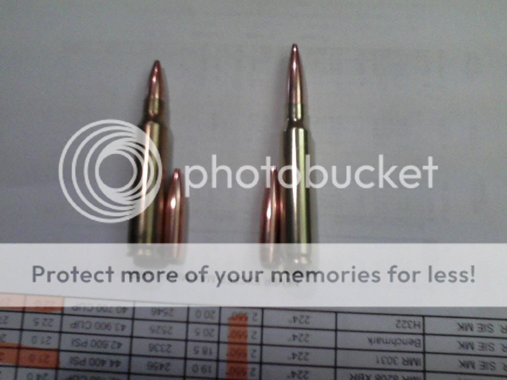

Here's why they're always available. They're loaded way beyond mag length because they have a more VLDish ogive. 77 smk left, 80 smk right.
