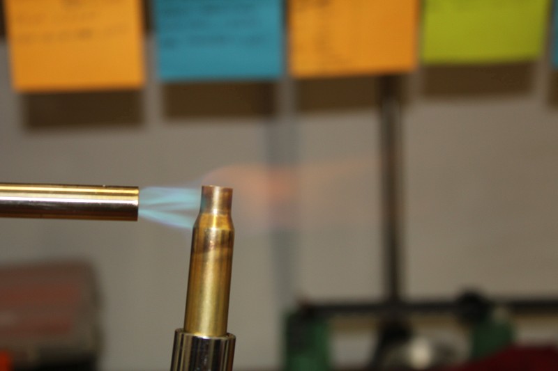

Here is some pics of a gas , heat and flame size test I did . These were all done using 308 cases and placing 750* tempilaq inside the necks ( to keep it from being directly in the flame and 450* just below the shoulder .
Here is the propane torch and FWIW this is the socket and drill method .
Just as the case enters the flame
Just as the temp indicators melted both inside the neck and below the shoulder
After leaving in the flame 2sec after temp indicator melted
Note , the longer the case is in the flame or hotter it gets the more yellow/orange the flame gets . I have a theory as to why but it's just a theory with no evidence to back it up . My theory is since zinc melts and breaks down at a much lower temperature then cooper . It's the zinc starting to break down causing the change in flame color . When I say break down I mean "maybe" molecules are burning off the surface of the case not that all the zinc is being destroyed or anything like that .

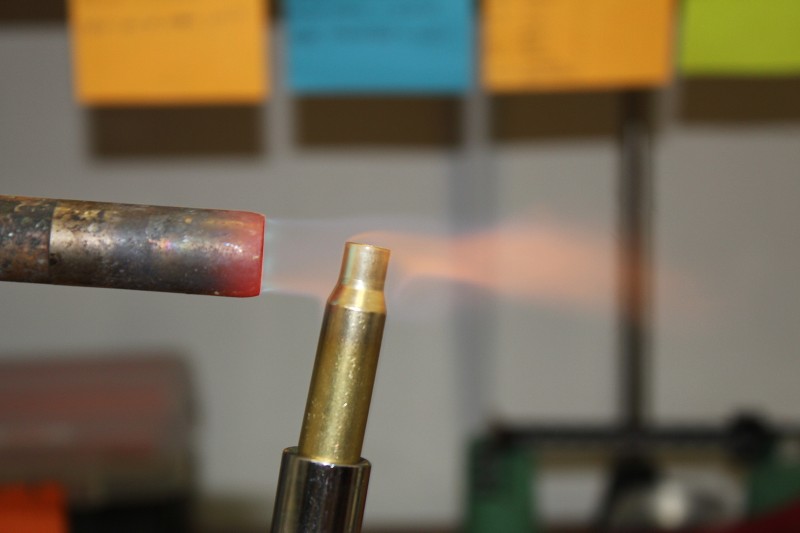

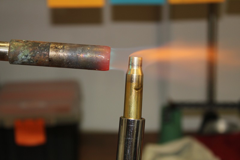

Here is pics of me trying MAPP gas to anneal . Note : I'm in construction and the MAPP gas I used was my plumbing set up so It likely did not have the best end for the application .
This was right as the case entered the flame . As you can see the discoloration of the flame started immediately and only got worse the longer it was in the flame
2sec after the temp indicator melted

Propane was by fare the best and most controllable heat source . The MAAP gas was to hot to start with . Heated the case to fast and it was hard to remove the case from the flame at the correct time . By the time my eyes saw the temp indicator melt and me actually removing the case from the flame . The case neck had already over heated . Not likely by much but the propane was much easier to control .

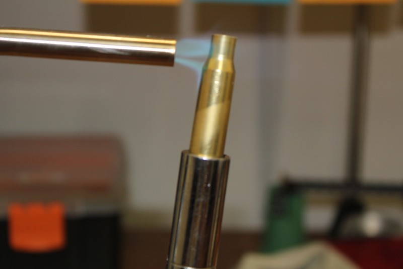

I also did test trying to see why you get anneal marks and how they happen . My test showed it to be less the case hitting the correct temperature and more the heat of the flame and where it was placed on the case . I had a fantastic photo showing this but was lost to the computer gods .
I do have this photo showing a propane torch turned down low annealing a case . This is right when the two temp indicators melted and is the only photo I have that shows the actual tempilaq on the case as it melted . Note there are NO anneal marks on the case and yet the case reached the proper temperature .
