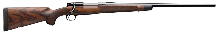

I'm seeking some assistance regarding the port ejector spacing, namely on the recess. Should this area be symmetrical at each end? There are an abundance of variations which lead me to believe that there are many errors. The specific model I'm referring to is a Winchester Super Grade French Walnut, chambered in .308. All replies are appreciated.Winchester Super Grade French Walnut .308.png

Of course it should be symmetrical. I'd get this back to the dealer/factory to rectify the error. Rifles much cheaper than this manage to do better.

* "Correct Ejector Port Spacing as Seen on the Winchester Website".Winchester Model 70 Super Grade French Walnut - 535239228.jpg
The rear bridge on the receiver, in the first picture, appears to be shorter than the one in the last picture.
Yes, no question there: 'As this entire thread encompasses that fact'. The latter Super Grade French Walnut is representative of the actual photo on the Winchester Website as stated in my prior post. I may have not clarified that aspect.

The short action M70s we're made with two different ejection port lengths. It appears this stock was inletted for the shorter version.

I have owned both versions and it can also be clearly seen on your posted photos.
There is only "one" photo, not 'photos'. the # 1. photo depicts a short action .308 in that the port ejector spacing is "too short". The # 2. photo is a clear representation from Winchester as 'pictured' on their website (.308 Super grade French walnut) as being "symmetrical". Naturally, the long version will have a different port ejector bevel. You know not what your speaking of.

One more try... there are two different versions of the SHORT actions. The difference is in the length of the rear bridge section which in turn creates the different ejection port lengths. Both versions have the same action length and receiver screw spacing.
