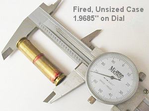

Here's a cheap tip. You can use a .45acp shell case to determine the amount of shoulder bump,setback) you are putting on your cases. Resize the .45 acp case,to make sure it's round), trim the casemouth square, and remove any burrs on the case mouth. Then slip the .45 acp case over your sized, unprimed 30BR round and put the two between the jaws of your calipers. Then compare this with a fired, but unsized 30 BR round,primer removed).

PS, if it wasn't clear from the above pix, you need to remove primers from both your 30BR case and the 45 acp case so they seat flat on the jaws of the calipers.
