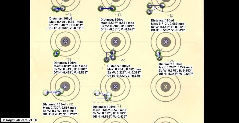

I just happened to test seating depths today and found little velocity difference. This was in a 308win using 200 hybrids
-10 off lands 2575
-13 off lands 2587
-16 off lands 2571
-19 off lands 2569
-22 off lands 2578
-25 off lands 2571
-28 off lands 2574
-31 off lands 2573
-10 off lands 2575
-13 off lands 2587
-16 off lands 2571
-19 off lands 2569
-22 off lands 2578
-25 off lands 2571
-28 off lands 2574
-31 off lands 2573
Andrew,
do you have target pictures to go with your data? How do you define "the lands"? Why are you starting at -.010?
IME, using the 200 hybrid, the best groups are between .005 and .010 off the lands.
Don't forget that the objective is to find a spot where small depth changes have little influence on the POI. It seems that you may have found the spot between .025-.031, but without seeing the targets no one is going to be able to answer your question.
Kindest regards,
Joe
Seems -10 and -13 are good. I believe I caused the outside shots with maybe different shoulder pressure or something.
