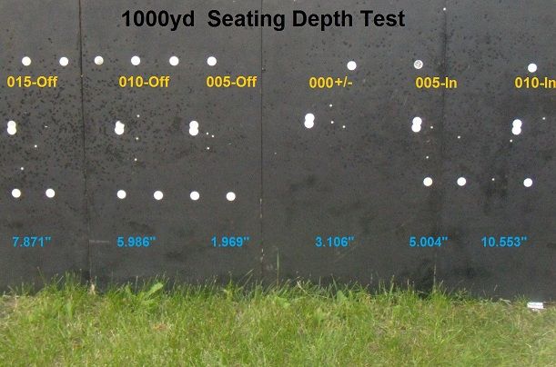

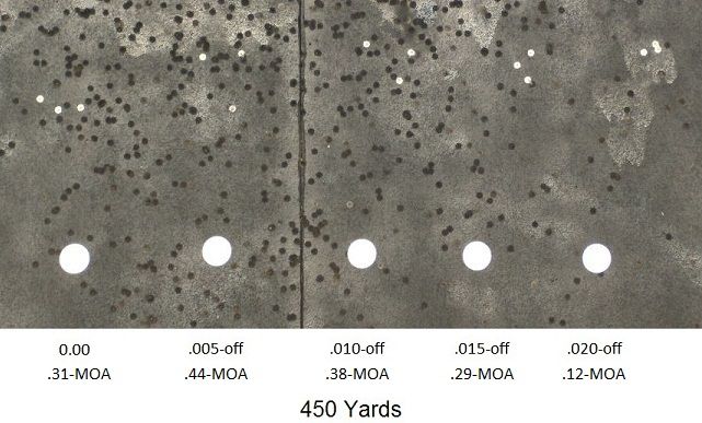

dmoran said:
My experience is, there is very little change in velocity and/or pressure from In the Lands -to- Off the Lands.
There also is very little change to POI on the targets, which physically proves the lack of increased velocity from In to Off.
Below is a seating depth test:
Notice the change in vertical dispersion (ES) between each group, but how little over all change to the POI heights.
Which shows well how little the total velocity spread was effected by seating.
Below is a 450-yard seating test: notice with this one, as the seating was moved away (Off) the POI to each group slightly rose.
Hence the velocity increased linearly Off the rifling, do to increased load density of this specific load combination of a high starting density.
My 2-cents
Donovan
Are those the same loads at both yardages? Interesting how the best at 450 was not the best at 1k ;)
