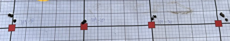

I did a quick scan using 109 Berger Hybrids. I have dropped down to 2830 fps and set 10-20-30-45 off touch point. 3 shots each.
Clearly did not like 10 or 45 off but both 20 and 30 off were indicative of a good seating depth. I will use 0.020” off for a string in a 600 yard sling match this weekend. I may look at 0.015, 0.025 off and see if it gets better or if this is just a good “ flat spot” in seating depth.
