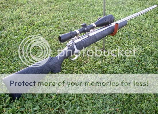

Hey all. I'm considering a project to be built on a short Remington action. This is the parent rifle,the donor if you will.
What I want to do is rebarrel and true up this old girl ,from 22/250 to something in the way of a combination round. Suitable for deer/antelope and woodchucks as well. I want to keep the bolt face as is,so I'm limited there. I've done the 6mm thing to death so the 243/6mm Rem aren't in the running. .27, .284, or .30 would be great. Accurate to 600 yds. Wildcats welcome. Any sugestions?
