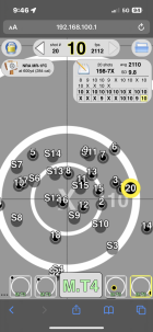

This is just my recent data from the Missouri State F-Class match this last weekend shot on Shotmarker targets.
Different target number on stage 4 of day one, and on day 2
Each can decide whether it has any usefulness.
I don't know my MV or MV SD.
Rifle 6mm BRA
4-20 shot stages Saturday and 3-20 shot stages Sunday
Unlimited sighters on 1st stage of the day and 1 or 2 convertible sighters on other stages.
Very slight quartering headwind Saturday, a little more switching Sunday forecast less than 8mph
Maximum elevation of shots on any target was 3/4 MOA
Interesting how much velocity increased throughout the day.
Stage - SD - Score - Vel. @ target - # shots including sighters
1 - 6.3 - 200-15x - 1913 - 30
2 - 9.2 - 200-15x - 1935 - 21
3 - 7.6 - 200-15x - 1933 - 20
4 - 9.5 - 199-10x - 1974 - 20
5 - 9.2 - 200-14x - 1951 - 29
6 - 20.0 - 199-13x - 1975 - 20
7 - n/a - 199-14x - n/a - 22
I missed getting a picture of the last target before leaving the range so don't have SD or velocity data for it
Two 9s were near corner shot hold errors and one was a waterline hold error
