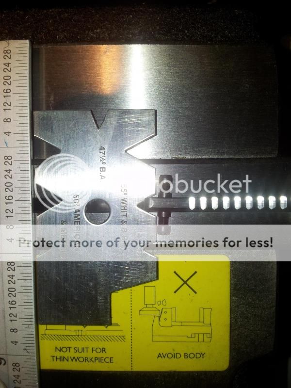

Here's a couple of problem that have shown up recently on new scales.
The first photo shows a knife edge several degrees out of vertical. (easy to fix)
The second shows the pan hanger knife edges way out of square with the beam. (not so easy to fix)
someone should make a attribute gauge to check the knife edges for correct angle. It would have to be tiny used with a magnifying glass with my blind eyes
The thread angle gauge shown in the second photo works well to check the knife edge angle. The knife edge sits snugly in the 60 degree "V" and you can then see if the gauge body lines up with the beam.
The knife edge is just a press fit in the beam, not splined. It can be pressed one way or the other to centre the beam up correctly and rotated to set vertical.
To set vertical I grip the knife edge in a smooth faced vice, gripped on the round part right close up to the beam, then just rotate the beam a little.
