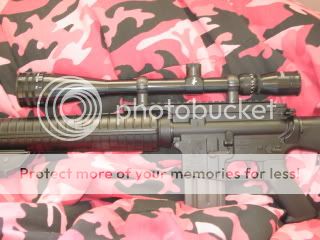

Here is my AR. GG&G scope rail and Burris Signature Zee high rings. Scope is a Tasco, but just for reference ... it is a 44mm Obj, and is 17" long. I think with setup, you'd be very well setup on S3.
