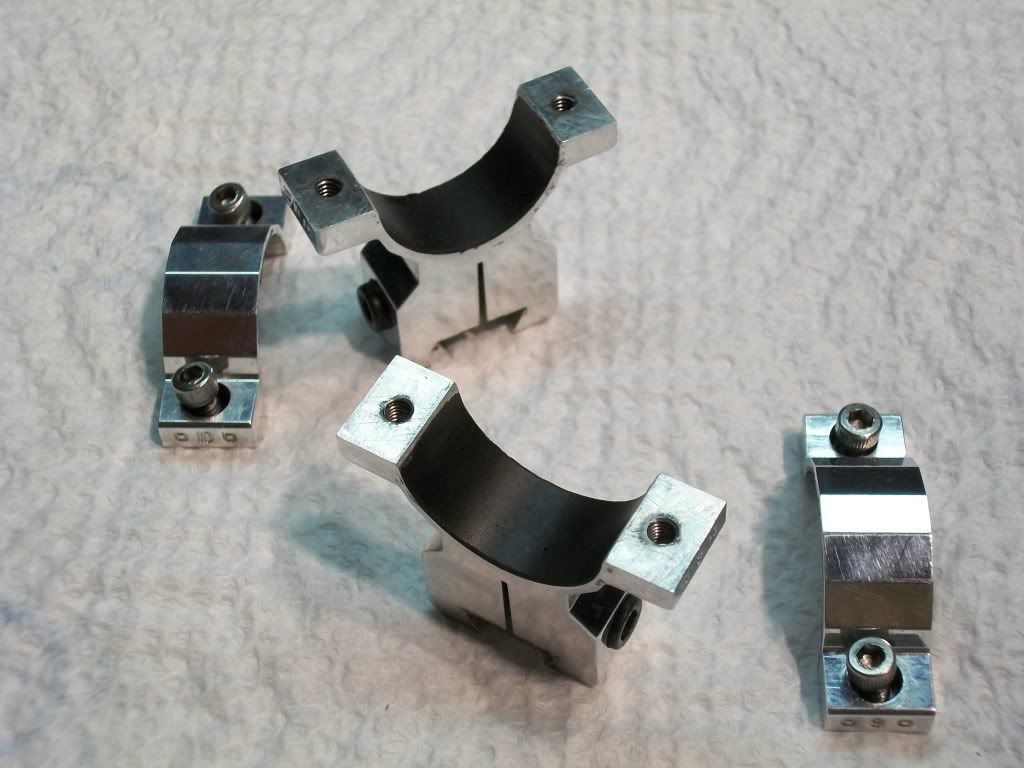

I bed all my scopes in the rings. Here's a pair of Kelbly single screw rings I bedded four seasons ago. This set of rings has had 7-8 different scopes mounted in 'em over that time. -Al
Al. What did you use as far as bedding compound? Also did you lap the rings before bedding? Did you remove any material or did the bedding stick without much prep? Please elaborate on your process. Thanks
