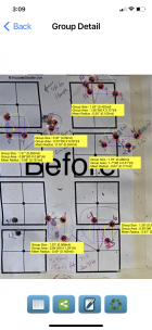

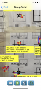

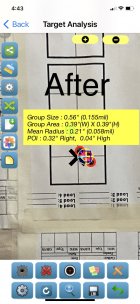

Here are pics of just the 300wm groups with nightforce scope and the old groups with the Arken scope. I realize how bad I am at posting so I wanted to try and isolate the difference. The only reason for posting this is to show the size and shape of groups to help others figure out there problems.
pic#1___ 300wm with Arken scope "only groups highlighted" you can see that there is one small group but mostly everything is way off and its interesting how symmetrical the groups look.
pic#2 & pic#3___ "only groups highlighted" 300wm with Nightforce scope. You can see groups are all under .7" I only shot 13 rounds of 300wm and some of those missed the target because I didn't want to adjust the scopes but there was 20moa difference so i had to use the top of reticle for aiming. The only poi shifts are from me trying zero rifle I forgot i was using a 2nd focal plane scope at half power and my adjustments weren't correct.
How do I tell which groups belong to what?
It’s just the highlighted groups from SubMOA app. Anything not marked was either old shots or me adjusting for a zero. That’s why I didn’t mark an aim point on anything. You can see all groups in first pic are mostly huge with one small random group. After swapping scopes everything went back to normal .5-.7moa size groups

Yes I do believe it is always set as close I can get it. If you look at the pictures you can see that the groups are all over the place. But if you look at how square shaped some of the groups are they just have a sort of mechanical look to them. I was measuring one of the groups and it is within .01 in relation to the bullet holes only close to an inch apart. If it was just me you would see groups more dispersed.
