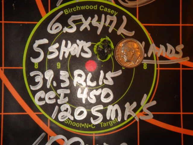

woolenmammoth, give us some details on your gun?
My 6.5x47L loves 123 Scenars! My 338 loves 300 grn Scenars! FYI
Check out the 36.2 load from my 6.5x47L
Dennis,
If that will reproduce,..were all in trouble ;)

Now you put 120smk's or 123 Scenars in my gun, and it will plain shoot! It was again proven this last Thursday as I was outshooting several good shooters with my gun and the 123's. After the third string, they actually came to me and wanted to know what I was shooting. I was "very" windy during our practice.
The barrel on my gun doesn't like high pressure with the heavy bullets, but you put 39.3 grns of RL15 behind a 120smk, it will just enlarge one hole with 5 shots! NO pressure signs!
