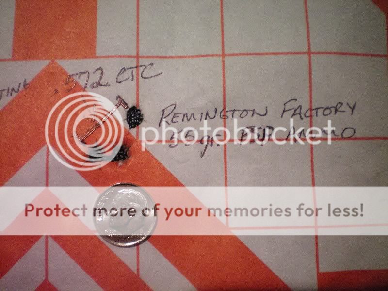

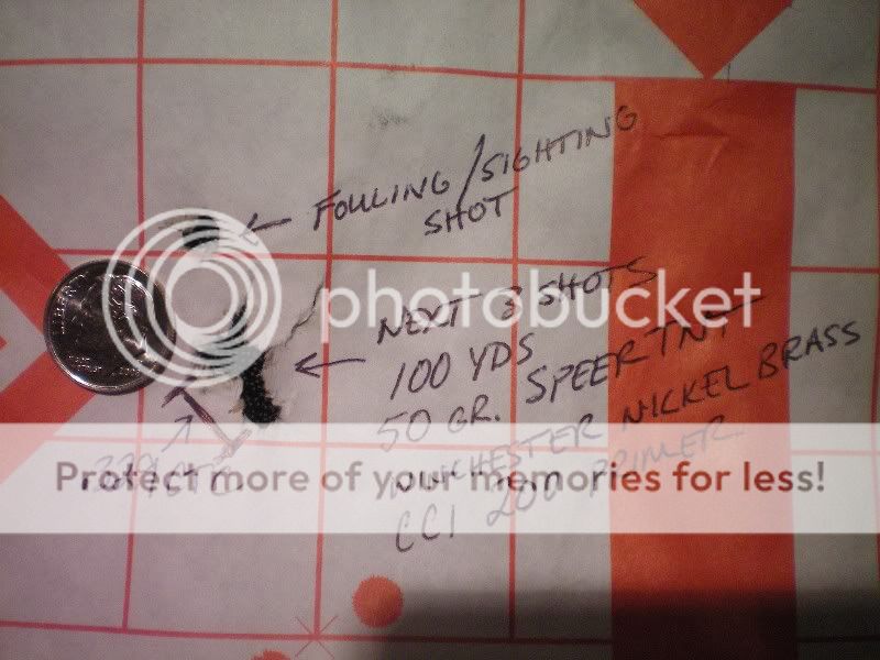

I have a couple custom Savage rifles. One is a 20 VarTarg built on a Savage 10 short action and is a 5 shot 1/4 MOA rifle. Extremely accurate.
I bought the rifle as a used 22-250 with a whippy thin #2 contour barrel originally. My plan was to build the VarTarg immediately. Only bought the rilfe as a 22-250 because it was the best deal I could find at the time on a Savage short action for my 20 VarTarg project.
But to sell the factory barrel that I wouldn't need anymore, I wanted to see how it shot with some hand loads. I like to post some targets with a barrel if it shoots good. Helps it sell quicker.
I grabbed 4 rounds of my Father's 22-250 handloads using 50gr Speer TNT's powered by Accurate 2230. Shot 1 round to foul the barrel real quick, then fired my 3 shot group in rapid succession. I didn't expect it to shoot very well with the barrel being so thin and being from the factory. The dang thing shot under 1/3 MOA at 100 yards! First load I tried! So I thought, "ok...lets try some factory ammo to see what it will do for someone who is not a hand loader." Shot 3 rounds of Remington 55gr PSP factory ammo. It shot 3 shots just outside 1/2 MOA!!!
Almost didn't want to sell it after that. But reluctantly I forced myself to sell because I knew I wanted that little VarTarg more, and this barrel sale would help pay for it.
So don't let that thin Savage barrel fool you. They'll shoot darn good in many cases if a person is willing to do some testing.
Here's the pics I posted with the barrel when I sold it. The fella who purchased the barrel from me has a real accurate 22-250 right now : )
