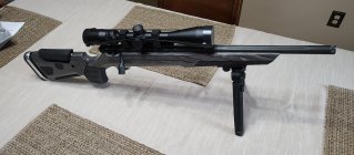

I have LH B14r,LH Savage MKII,Left and Right CZ457 and had a LH Vodoo.
Cz,...DIY versitility....,,barrel changes, stocks,scope changes and triggers availibility.I shoot a left and right CZ457,both have Jard triggers.I've converted many RH stocks to left
I 've shot ELR22 on Saturday with a Ziess S3 with a 50 moa base.Slide off the Zeiss with the base, slide on the Golden Eagle with high rings and a zero moa base ,add a 3" stock adapter,rezero,all in a couple minutes, then shoot RFBR on Sunday.Hunting season (starlings),slide on a 3-9 scope,remove the 25"Modacam barrel,install the factory 20.5" barrel.
